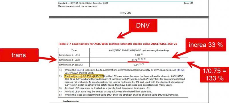

    Trong bài toán transportation, hệ số vượt tải allowable stress được phép tăng thêm 33%, như các đề cập của API và DNV như này đúng k nhỉ, (AMOD = 1.33)
    ------------------------------- API ----------------
    5.4 Fabrication and Installation Forces
    5.4.1 General
    Fabrication forces are those forces imposed upon individual members, component parts of the structure, or complete units during the unloading, handling and assembly in the fabrication yard. Installation forces are those forces imposed upon the component parts of the structure during the operations of moving the components from their fabrication site or prior offshore location to the final offshore location, and installing the component parts to form the completed platform. Since installation forces involve the motion of heavy weights, the dynamic loading involved should be considered and the static forces increased by appropriate impact factors to arrive at adequate equivalent loads for design of the members affected. For those installation forces that are experienced only during transportation and launch, and which include environmental effects, basic allowable stresses for member design may be increased by one-third in keeping with provisions of 6.1.2. Also see Section 15 for comments complementary to this section.
    --------------------------- DNV --------------------
