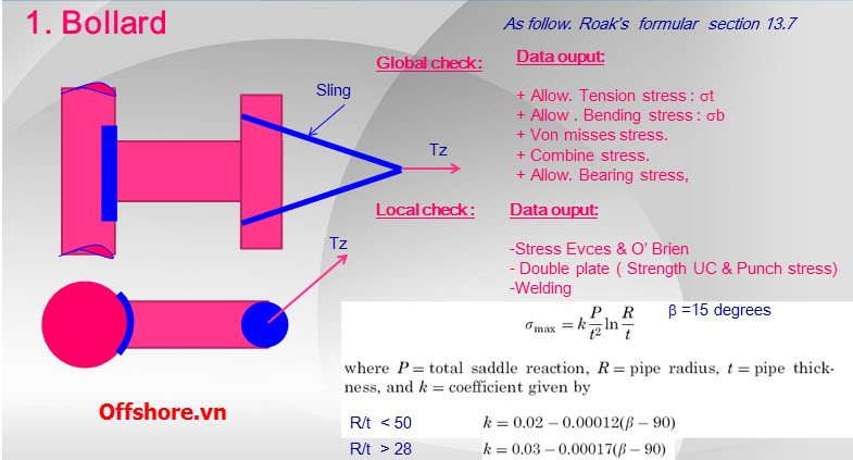

    3. Mooring Bollards Design

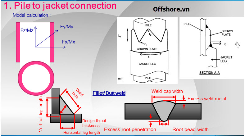

    9. Pile to Jacket Connection

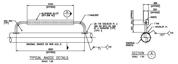

    20. Anode protector
    Hình ảnh minh họa:
    Hình 1: Chi tiết Anode

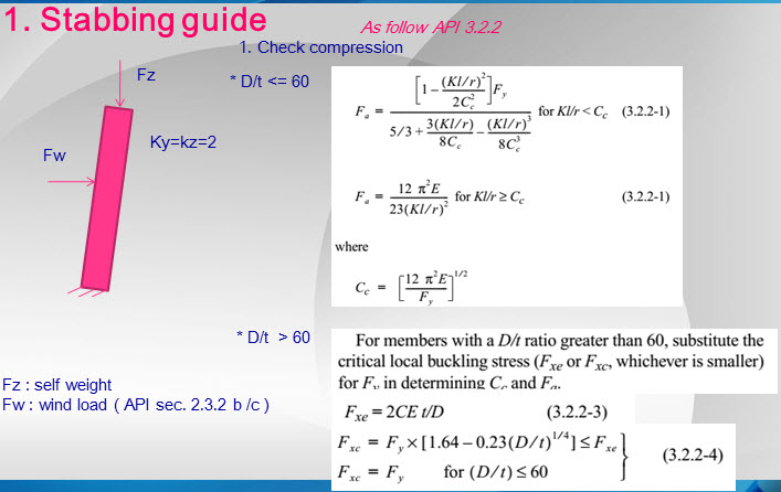

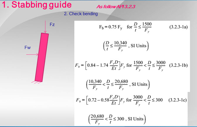

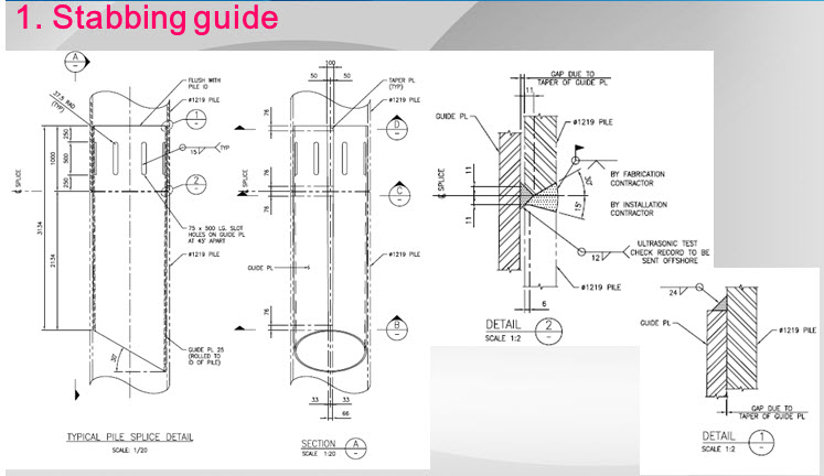

    8. Stabbing guide Design
    Cơ sở lý thuyết
    All stab-in guides and installation aids shall be designed for the following loads as minimum:
    1. Horizontal loads = 10% of the static weight of the lift object
    2. Vertical impact force = 10% of the static weight of the lift object
    An one third increase in allowable stresses is permitted.
