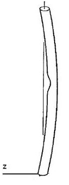

    Hình 1: Hình ảnh phần tử bị biến dạng
    Hình 2:Hình ảnh phần tử khai báo tương đương
    Dented Members
    Accounts for local indentation and overall deformation. The local dent and the overall deformation are in the direction of member local z direction. The length of the dent is the length of the member or length of segment. The local z can be orientated in any direction using a chord angle or a reference joint.
    Code check in accordance to modified API equations to account for reduction in cross section and overall deformation as per J.T. Loh paper “Ultimate Strength of Dented Tubular Steel Members
