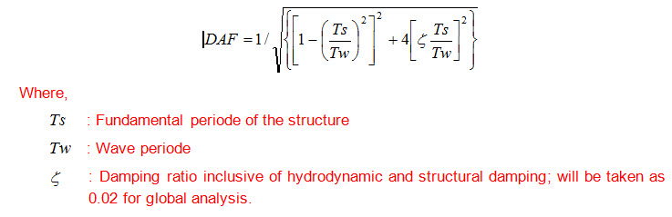

    Wave loads shall be adjusted by a Dynamic Amplification Factor (DAF) if the platform natural period is greater than 3 seconds. A dynamic analysis shall be performed to determine the platform natural period. The frequencies and time periods resulting from frequency analysis will be used to calculate dynamic amplification factors (DAFs) for use with wave loads in the in-place and the fatigue analysis for platform with natural period over 3 seconds. The wave DAFs will be calculated using the following formula, base on the fundamental frequency of the jacket in the two major global axes:
    DAF.jpg ​
    DAF tính theo công thức phụ thuộc vào Tần số dao động riêng của kết cấu, chu kỳ dao động sóng và hệ số damping
