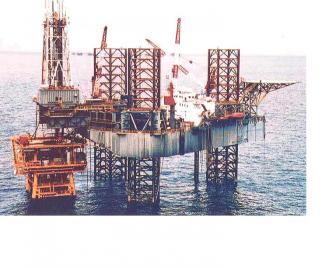

    In comparison to semi-submersibles, a jack-up has some definite advantages:
    1. Lower construction costs.
    2. Less personnel required to run the rig
    3. Because of (a) and (b) lower day rate.
    4. The possibility to work over a fixed platform.
    5. It is cheaper for the operator to use a jack-up:
    • Less power full boast to move the rig
    • No mooring system required –no lost to run anchors.
    • Surface BOP without subsea system.
    1. Less down time:
    • No wait on weather due to motions.
    • Drilling equipment can be handled faster and easier.
    However, the jack-up have some disadvantages:
    1. Limited water depth. The maximum water depth for the largest JU is 450ft.
    2. Depends on bottom condition. The bottom soil condition may cause a punch through or deep leg penetration.
    3. In case of a blow-out the rig cannot move off location.
    4. More fragile. Many incidents and damages during moving and because of a punch through. Statistics have shown that over 75% of the incidents occur under tow or during jack-up/jack-down operations.
    5. Safe operations require strict procedures.
