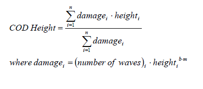

    Due to the non-linear nature of soils, the natural period of the structure is dependant on the wave height used to develop the linearised pile-soil superelement used in the modal analysis. For a fatigue analysis, the superelement should be generated from a wave height equal to that of the “centre of damage” fatigue wave.
    The centre of damage wave is an equivalent wave that represents the spectrum of fatigue waves to which a structure is subjected. For n wave heights, the centre of damage height is calculated as:
    The constants b and m are defined by the joint stress-wave height relationship and S-N curve
    respectively. If it is assumed that stress is related to wave height as follows:
    Then, generally, 1.0 ≤ b ≤ 2.0. The value of b is platform-specific, and can be calculated by plotting the axial plus bending stresses of several primary members under the action of waves of various heights (with no current, dead loads, etc).
    The other constant, m, is equal to the negative inverse slope of the log-log S-N curve. For API RP2AWSD X and X’ curves, the values of m are 4.38 and 3.74 respectively.
    The fatigue analysis will be most conservative when the product b·m is large, since this gives a larger centre of damage wave height, lower pile stiffness, longer natural period, and hence larger DAFs.
    The COD wave height is simple to calculate from deterministic wave data, since the height vs. number of occurrences data is explicit. This is not the case with spectral fatigue data, which is generally set out in percentage form for various wave period/height combinations. If no equivalent deterministic fatigue data is available, it may be necessary to estimate the COD wave height.
